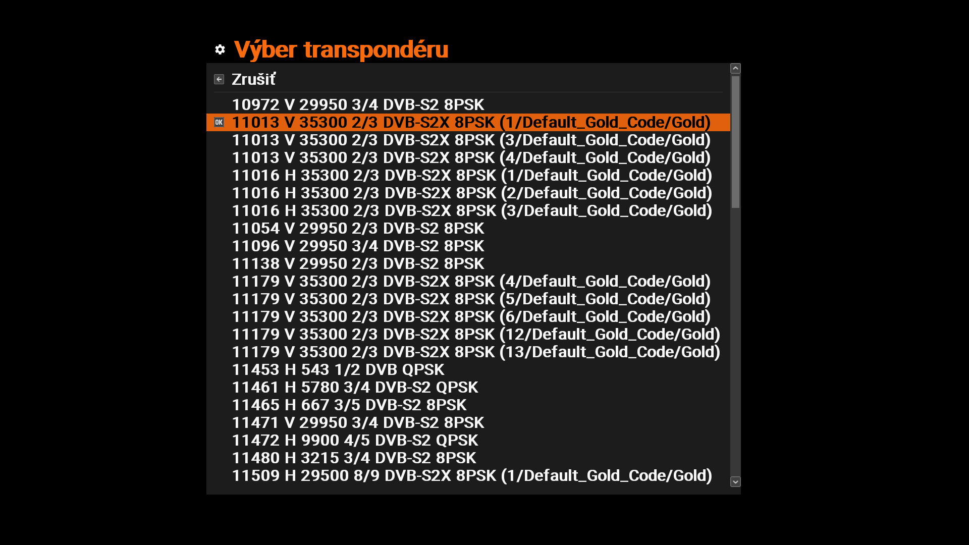

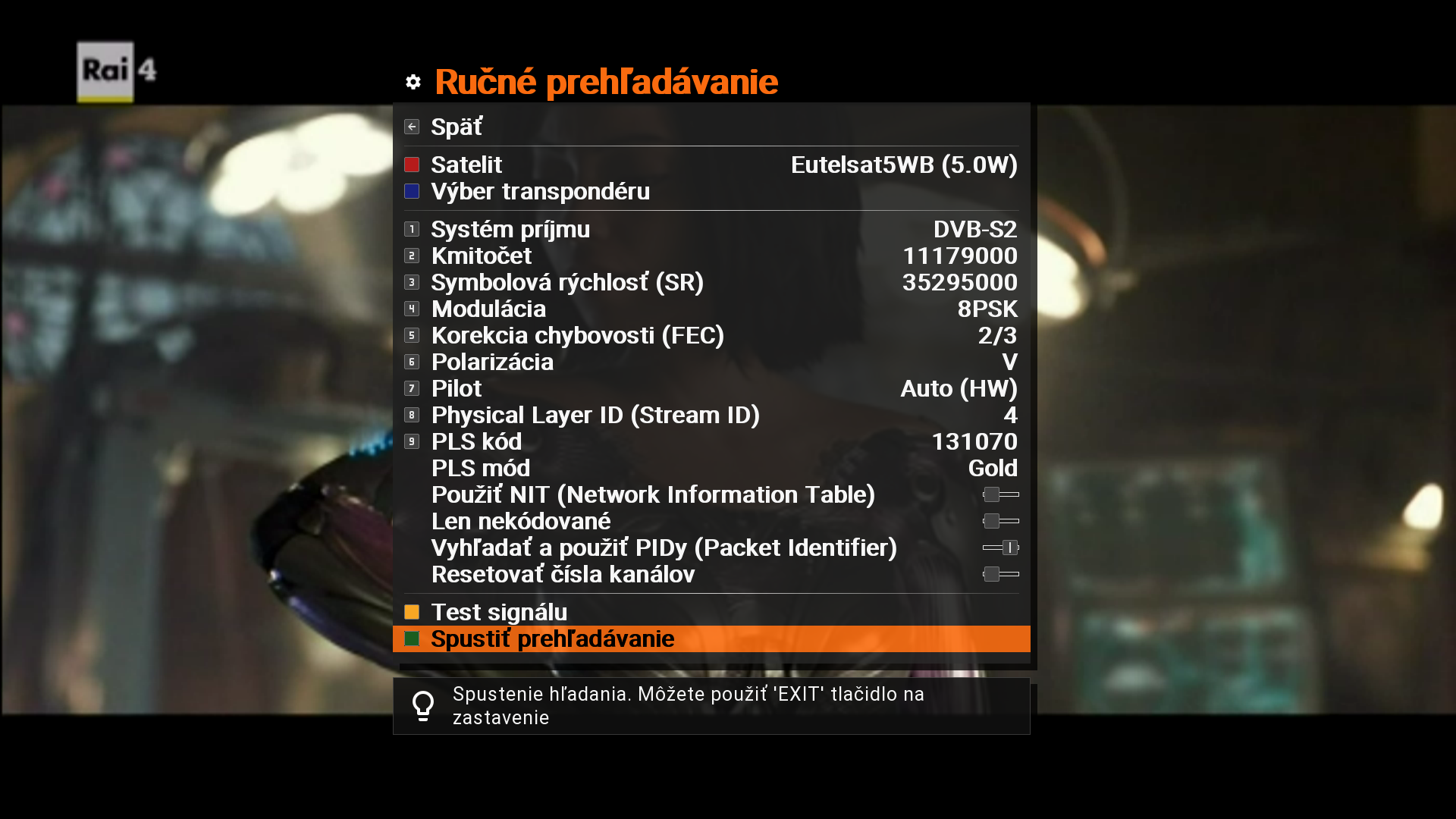

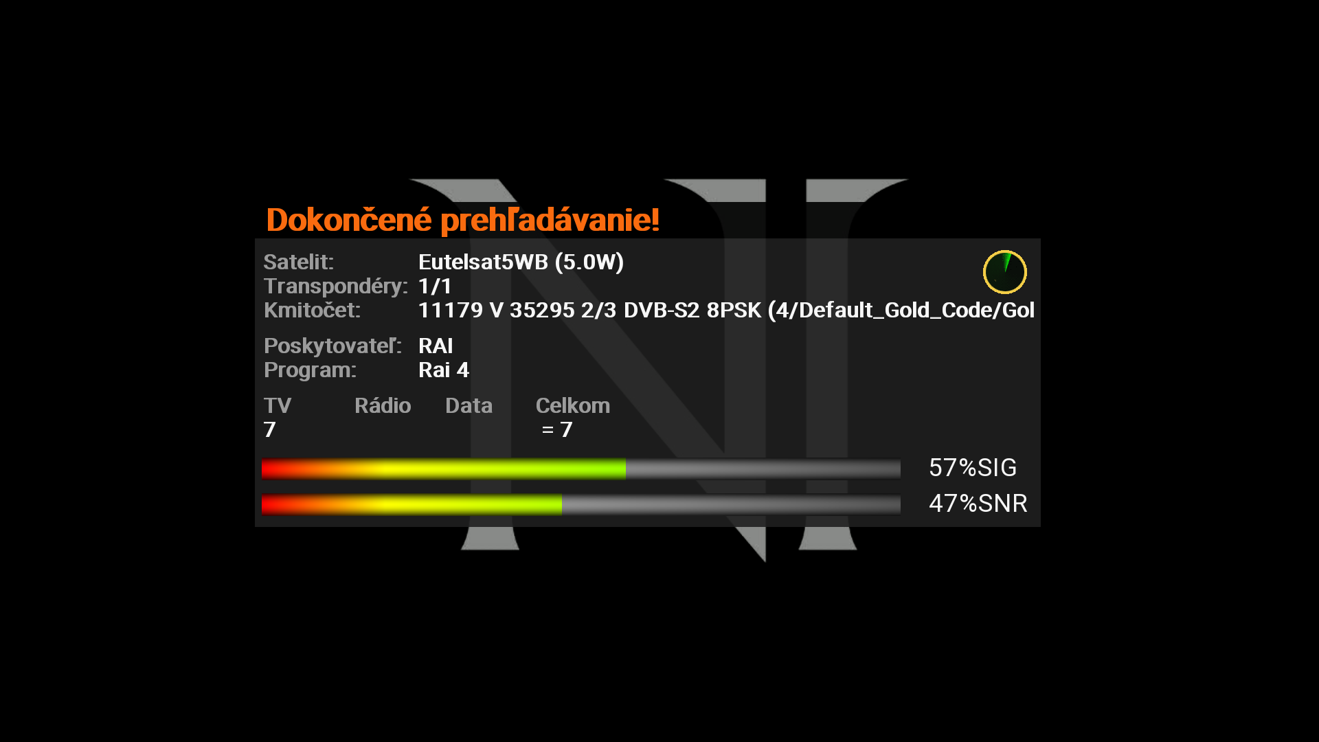

--HD51-- Arbeit nur Gold PLC
DVB-S2X with Root - erkanntes Signal, aber nicht scannen DVB-S2 with Gold or Root --satellites.xml--
system:
0 = DVB-S /sys 1/
1 = DVB-S2 /sys 2/
? = DVB-S2X /sys 4096/
2 = DSS /sys 128/
3 = Turbo /sys 256/
4 = ISDB-S /sys 512/
plm (pls mode):
1 = Root (default) and Gold /accept only GOLD PLC etc.131070 for RAI/
2 = Combo /accept only ROOT PLC etc.16416 for RAI/
3 = Unknown /accept only ROOT PLC etc.16416 for RAI/
großer Fehler DVB-S2 aus satellites.xml erkennen und als DVB-S2X anzeigen !!!
<transponder frequency="11013000" symbol_rate="35300000" polarization="1" fec_inner="2" system="1" modulation="2" is_id="1" pls_mode="1" pls_code="131070" />

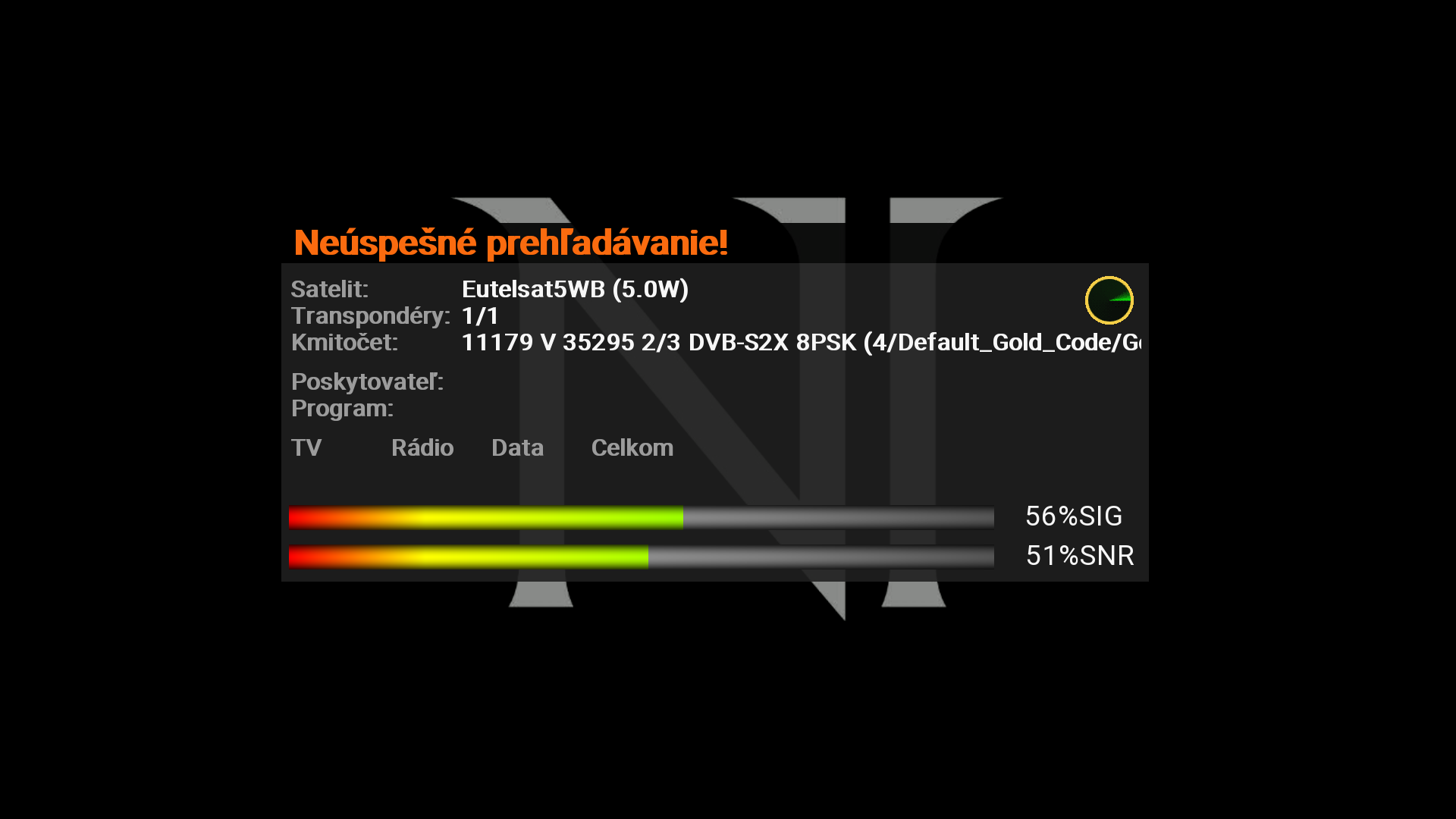

[femanager.cpp:getScanFrontend:814] Selected fe: 0
[scan] scanning sat Eutelsat 5 West A (5.0W) position -50
[scan] NIT no, fta only: no, satellites single
[scan] tp-id 2b05f03200010001 freq 11013000 rate 35300000 fec 2 pol 1 mod 9 pli 1 plc 131070 plm 1 sys 4096
[scan] add tp from settings: tp-id 2b05f03200010001 freq 11013000 rate 35300000 fec 2 pol 1 mod 9 pli 1 plc 131070 plm 1 sys 4096
[scan] scanning tp from sat/service
[scan] scanning: tp-id 2b05f03200010001 freq 11013000 rate 35300000 fec 2 pol 1 mod 9 pli 1 plc 131070 plm 1 sys 4096
[scan] [fe0] does not support delivery system 4096, skipping
[scan] found 1 transponders (1 failed) and 0 channels
