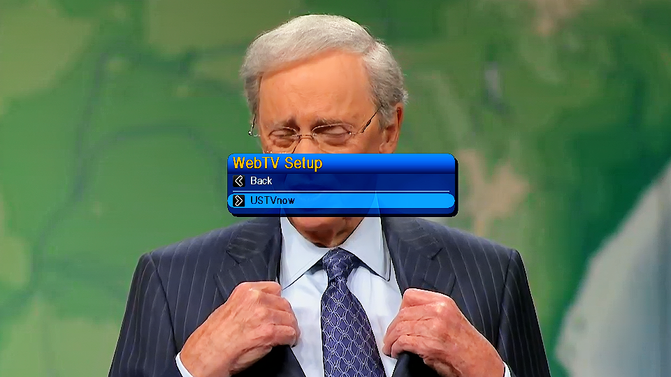

ustvnow.lua - WebTV script for USTVnow channels
webtvsetup.lua - WebTV Host setup plugin
Install:
copy webtvsetup.lua to Plugin directory (/var/tuxbox/plugins)
copy ustvnow.lua to WebTV script directory ( /var/tuxbox/plugins/webtv)
copy ustvnow.xml to WebTV config directory (/var/tuxbox/config)
reload plugins
Set WebTV configuration (Main Menu->System settings->Multimedia->WebTV)
- add script directory to WebTV script path
- add ustvnow.xml file(s) to WebTV XML files

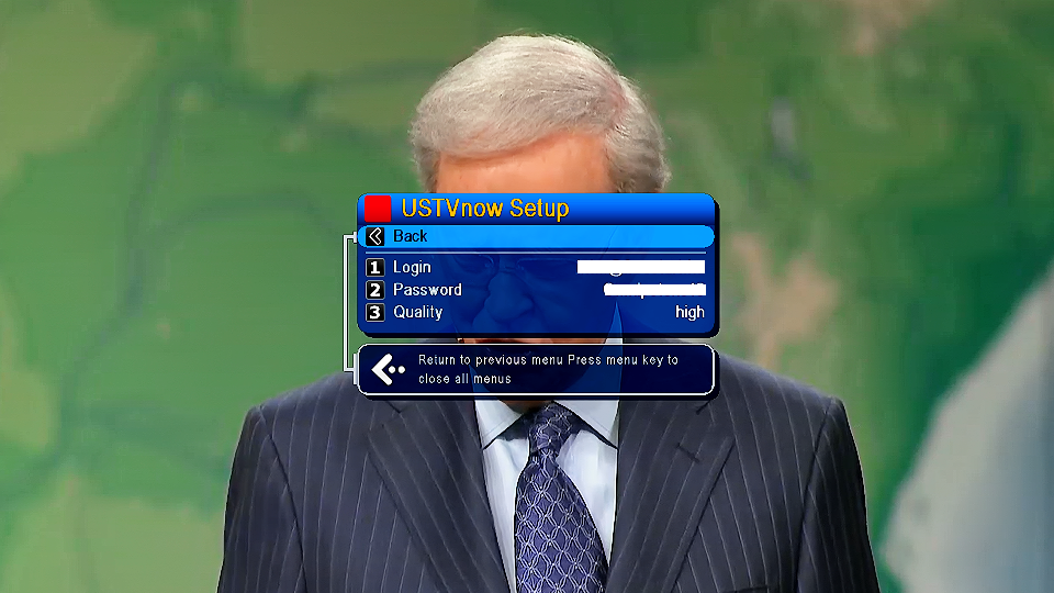

Setup USTVNow host:
- sign up an email login to http://www.ustvnow.com (7 HD channel ABC,NBC,CBS,FOX,CW,My9,PBS free!)
. start WebTV Setup pugin, select USTVnow host and enter login data
Use as WebTV normal channels

made an account there, put it in the .conf, but on selecting an ustv-webtv-channel:
Feel free, to tell me what to do to help solving this issue...
edit: on Nevis (HD1-Platform!), Image is NI of 7.11.2016 (not the newest, I'm afraid, but that should be sufficient)
edit2: also see the error above regarding the "checkVersion" in line 2 (made it bold)
edit3: i was also a bit confused regarding the paths of where to put the different files (bcoz of nevis-platform(no persistent /var!), but thats a general Neutrino-problem imho, as you can see above, it should work in general, but, just to mention it, I did a plugin-reload, but not a reboot (coz i'm watching sth)
(puh! what a sentence

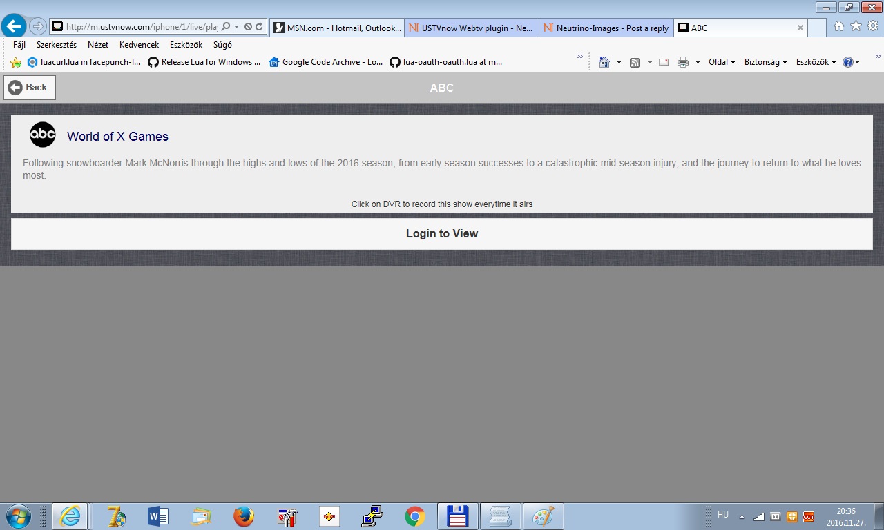

Is Your login correct?
Can you play channel with Browser? (Chrome)
Try it on this url:
http://m.ustvnow.com/iphone/1/live/playingnow
Celeburdi
Try it on this url:
Celeburdi

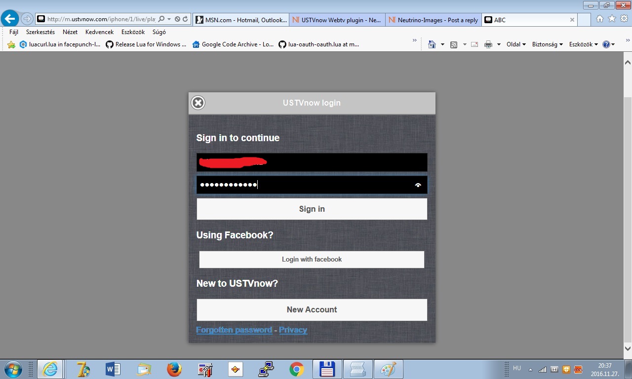

yes, that is working. And therefor I assume, that my login is correct.Can you play channel with Browser? (Chrome)
no, that doesn't work: "USTVnow Login Failed. Go back to try again or click below if you forgot your password." But the password is definitely correct. So, that seems to be the problem, but why? How to debug this???Try it on this url: http://m.ustvnow.com/iphone/1/live/playingnow

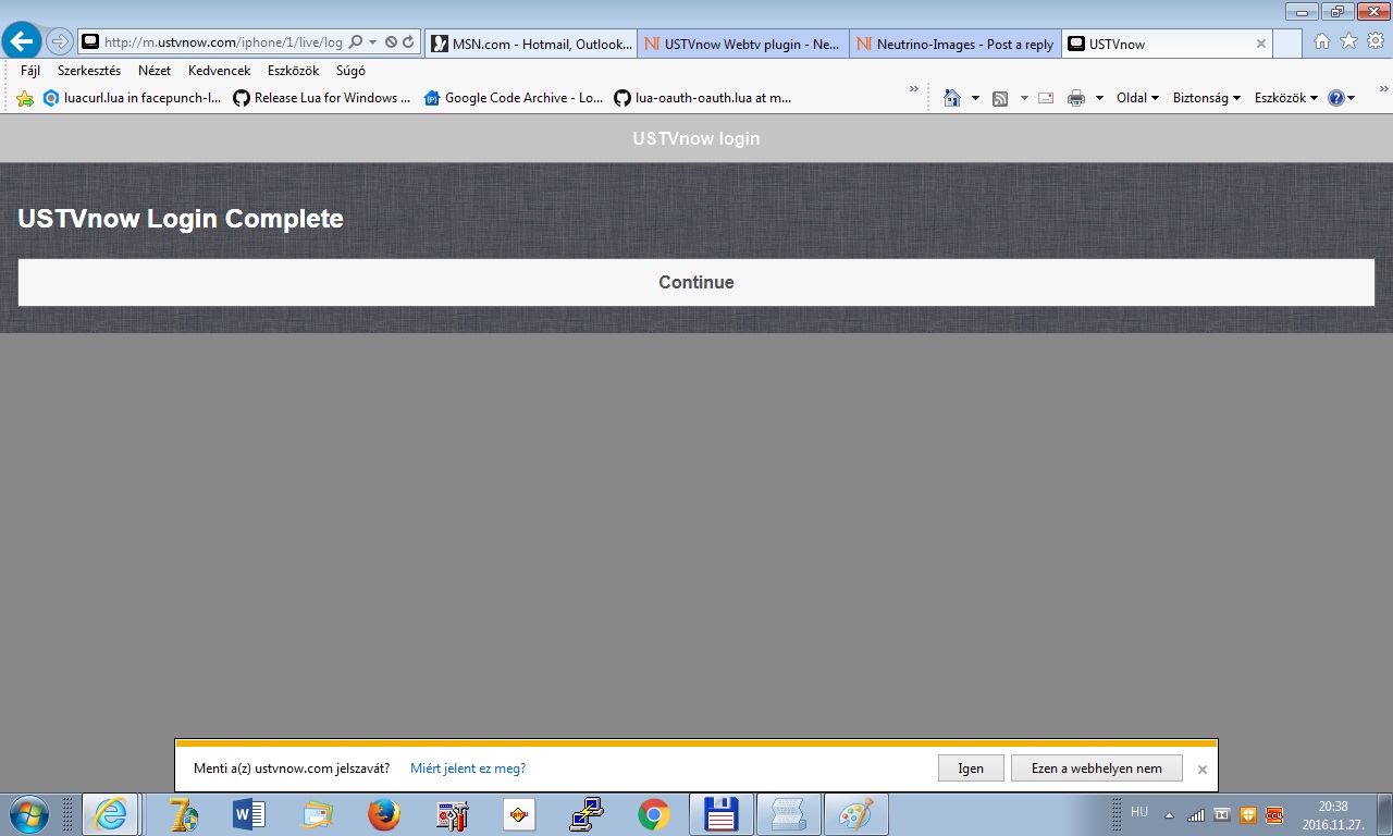

I can login on this link:
The plugin uses this link for login.
bye
