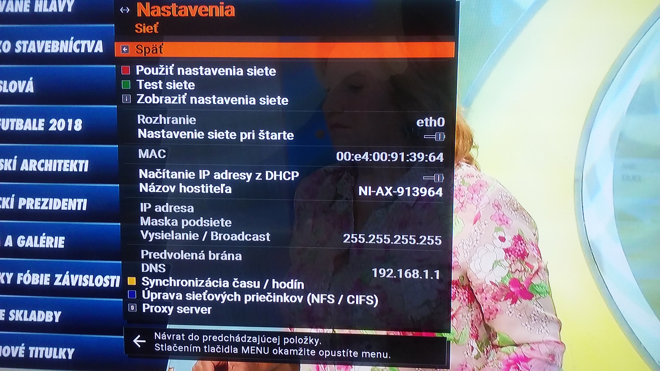

EnoSat
- Beiträge: 60
- Wohnort: Slovakia
- Box: MIO4K+ & HD51 & Solo4K
After restart missing network address
Gibertini OP100L /85E-53W/
You are using DHCP ! IP/address configuration is disabled
Try Info-Button (show active configuration)
